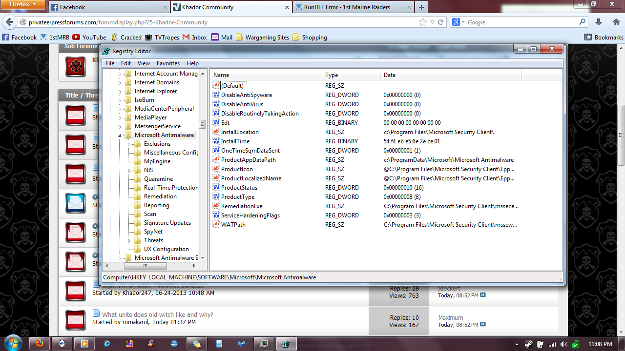

Brief Description of Issue: I was recently attacked by the MoneyPak FBI Scam Virus, the one that locks up your PC with some bullshit that says your viewing child porn or animal porn and need to pay $x to not go to jail. After I removed it I kept getting ACMON.EXE errors so I searched online and found a cure by deleting ASUS Splendid Video Service. Then I reboot my PC, my AV (Microsolf security essentials) goes batshit insane and catches another Trojen.exe and removes it. Now when I boot up my PC I keep getting a Run DLL error, which I took a screen shot of to help identify. My google fu has failed me in finding a cure so I turn to my Radier Docs. post-1609-1372299778_thumb.png

That error is because something is trying to run a virus and can't find it because it's been removed by you or your antivirus.
If you're comfortable poking around in your registry, i would suggest a quick search for "suxpyrp" to see if you can find where it's being launched from...
The likely locations are
HKEY_LOCAL_MACHINE\Software\Microsoft\Windows\CurrentVersion\Run
HKEY_LOCAL_MACHINE\Software\Microsoft\Windows\CurrentVersion\RunOnce
HKEY_CURRENT_USER\Software\Microsoft\Windows\CurrentVersion\Run
HKEY_CURRENT_USER\Software\Microsoft\Windows\CurrentVersion\RunOnce
the wow.dll and that bit of random text, and a path to rundll, would be in the data column.
If you find an entry for that wow.dll in one of those folders, you can safely delete that entry,
If it's in the RunOnce folder then you still have a virus, or it would have gone away after a reboot.
